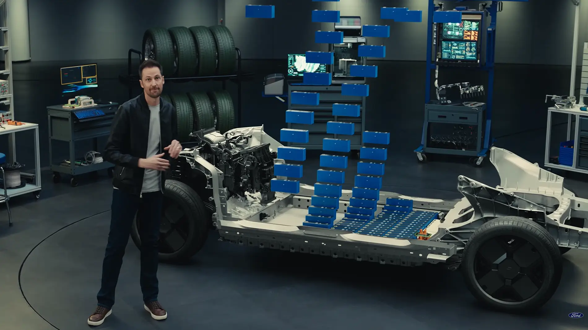

BATTERY SIZE:
The CGI video shows 6 Rows of 16 Battery Cells across = 96 Cells
Possibly there is a 7th Row that gets cut off in the video = 112 Cells
I
Cell Assumption:

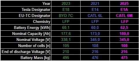

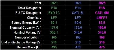

Tesla currently uses CATL's '6M' LFP Cell in the Model 3.
108 Cells
x 180 Ah
x 3.2 Volts
62.5 kWh
Ford is licensing an LFP Cell from CATL.
The general size of a 180 Ah CATL LFP Cell "appears" to be about the right size from the Ford video.
Applying the same CATL specs to what we see in the video from Ford.
96 Cells
x 180 Ah
x 3.2 Volts
55.3 kWh ( 64.5 kWh if there is a 7th Row of Cells not shown in the video)

BATTERY SIZE:
Cell Assumption:
108 Cells
x 180 Ah
x 3.2 Volts
62.5 kWh
96 Cells
x 180 Ah
x 3.2 Volts
